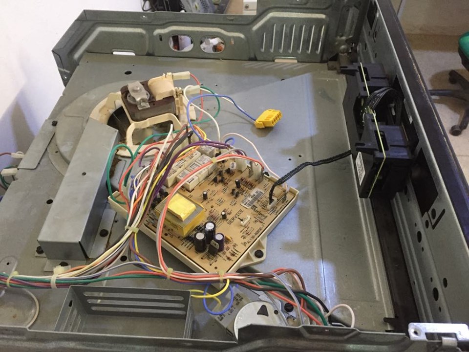

all hi
oven
type fcsp6 434
Whirilpool akz320 / mr
858 532 029 031
display pcb
Ge LIBRA
461,961,512,301
pcb power
461,961,512,342
sw; 12 pcb 221
the oven looks work fine and every thing in the display pcb work good. change the set up and start the cooking and it show cooking but the oven deoe not operate any motors or heating element eben lamp
it looks like in demo mode but it does not appear in the screen the word demo
le 05/05/2019 à 12:32
the transparent window located on the upper part of the furnace must be completely concealed by means of a black adhesive tape for the use of the appliance outside its installation niche
le 05/05/2019 à 14:33
thanks
it have some kind of sensor
le 05/05/2019 à 15:23
yes, there are two light-sensitive sensors

ceci une photo de four merci
